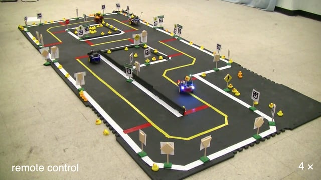

After the basic ROS for Autonomous Cars course, you should learn more advanced subjects like obstacles and traffic signals identification, road following, as well as coordination of vehicles in crossroads. For that purpose, our recommendation would be to use the Duckietown project. That project provides complete instructions to physically build a small size town, with lanes, traffic lights and traffic signals, where to perform real practice of algorithms (even if at a small scale). It also provides instructions to build the autonomous cars that should populate the town. Cars are based on differential drives and a single camera for sensors. That is why they achieve a very low cost (around 100$ per each car).
552172802_640
Image by Duckietown project
Due to the low economical requirements, and to the good experience that it may be for testing real stuff, the Duckietown project is ideal for start practicing some autonomous cars concepts like line following based on vision, other cars detection, traffic signals based behavior. Still, if your budget is even below that cost, you can use a Gazebo simulation of the Duckietown, and still be able to practice most of the content.

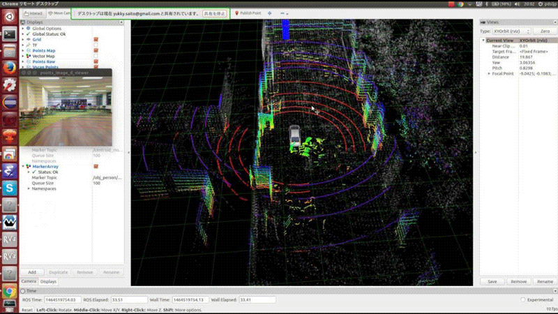

Then if you really want to go pro, you need to practice with real-life data. For that purpose, we propose you to install and learn the Autoware project. This project provides real data obtained from real cars on real streets, by means of ROS bags. ROS bags are logs containing data captured from sensors which can be used in ROS programs as if the programs were connected to the real car. By using those bags, you will be able to test algorithms as if you had an autonomous car to practice with (the only limitation is that the data is always the same and restricted to the situation that happened when it was recorded).
Image-by-the-Autoware-project-post-of-self-driving-cars-ros
Image by the Autoware project
The Autoware project is an amazing huge project that, apart from the ROS bags, provides multiple state-of-the-art algorithms for localization, mapping, obstacles detection and identification using deep learning. It is a little bit complex and huge, but definitely worth studying for a deeper understanding of ROS with autonomous vehicles. I recommend you to watch the Autoware ROSCON2017 presentation for an overview of the system (will be available in October 2017).

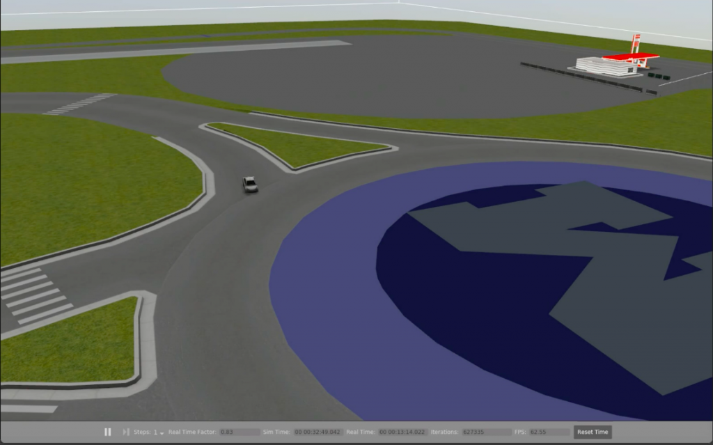

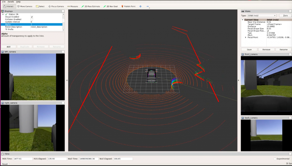

The final step would be to start implementing your own ROS algorithms for autonomous cars and test them in different, close to real situations. The previous step provided you with real-life situations, but always fixed for the moment the bags were recorded. Now it is time that you test your algorithms in more different situations. You can use already existing algorithms in a mix of all the steps above, but at some point, you will see that all those implementations lack some things required for your goals. You will have to start developing your own algorithms, and you will need lots of tests. For this purpose, one of the best options is to use a Gazebo simulation of an autonomous car as a testbed of your ROS algorithms. Recently, Open Robotics has released a simulation of cars for Gazebo 8 simulator.
Captura de pantalla 2017-09-28 a las 20.56.03
Image by the Open Robotics
That simulation, based on ROS contains a Prius car model, together with 16 beam lidar on the roof, 8 ultrasonic sensors, 4 cameras, and 2 planar lidar, which you can use to practice and create your own self-driving car algorithms. By using that simulation, you will be able to put the car in as many different situations as you want, checking if your algorithm works on those situations, and repeat as many times as you want until it works.
