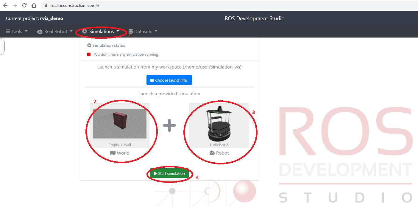

Step 2: Bring up a TurtleBot2 simulation
Head to the Simulations menu and launch one of the pre-configured simulations:
  1. Select “Simulations from the main menu”.
  2. Under “World”, select “Empty to World”.
  3. Under “Robot”, select TurtleBot2.
  4. Click “Start Simulation”.
ROSDS - Launch a simulation
You should now have something like this:
