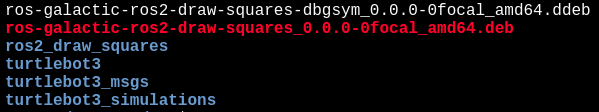

The command we just executed should have created a .deb file in the directory that is one level above. We can check it with:
cd ..
ls
Which should show us the following:
Debian file created
Debian file created
