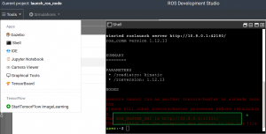

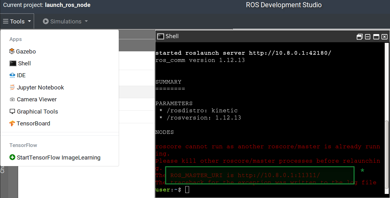

  • Start a Tools > Shell and start the roscore with following command
    $ roscore
This command starts the roscore. If the roscore is already running then it shows a warning message with roscore ip address information (as shown in green box in image)
The roscore starts as a node called /rosout. We can check the node with rostopic list command in another Shell

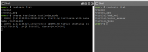

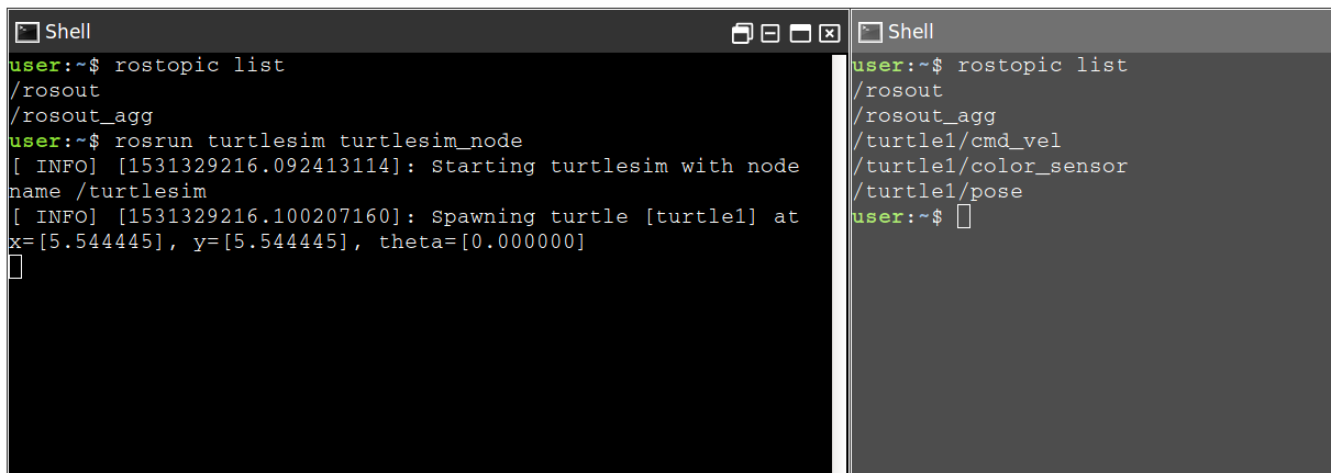

One way to launch a rosnode is using the rosrun command. For example
$ rosrun turtlesim turtlesim_node
This command will start the following nodes
  • /turtle1/cmd_vel
  • /turtle1/color_sensor
  • /turtle1/pose
We can verify these nodes with rostopic list command in a new window

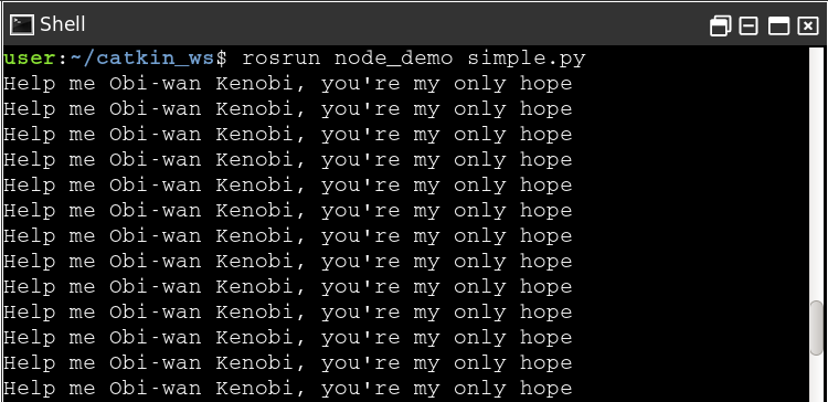

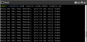

Next we will see about running a custom node. We will create a project using catkin_create_pkg command. Then we will create a python script with following contents
#! /usr/bin/env python
import rospy
rospy.init_node('Obiwan')
rate = rospy.Rate(2)
while not rospy.is_shutdown():
    print("Help me Obi-wan Kenobi, you're my only hope")
    rate.sleep()
## This program creates an endless loop that repeats itself 2 times per second
Next we will launch the script with the following command
$ rosrun node_demo simple.py
We can check if the node is running or not with rostopic list command in a new shell

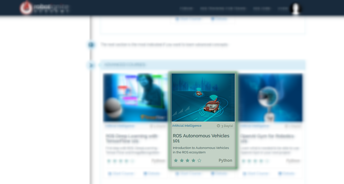

  • Go to Robot Ignite Academy. You will need to signup if you have not registered already.
  • In the home page, choose the course ROS Autonomous Vehicles 101 in the Advanced Courses category

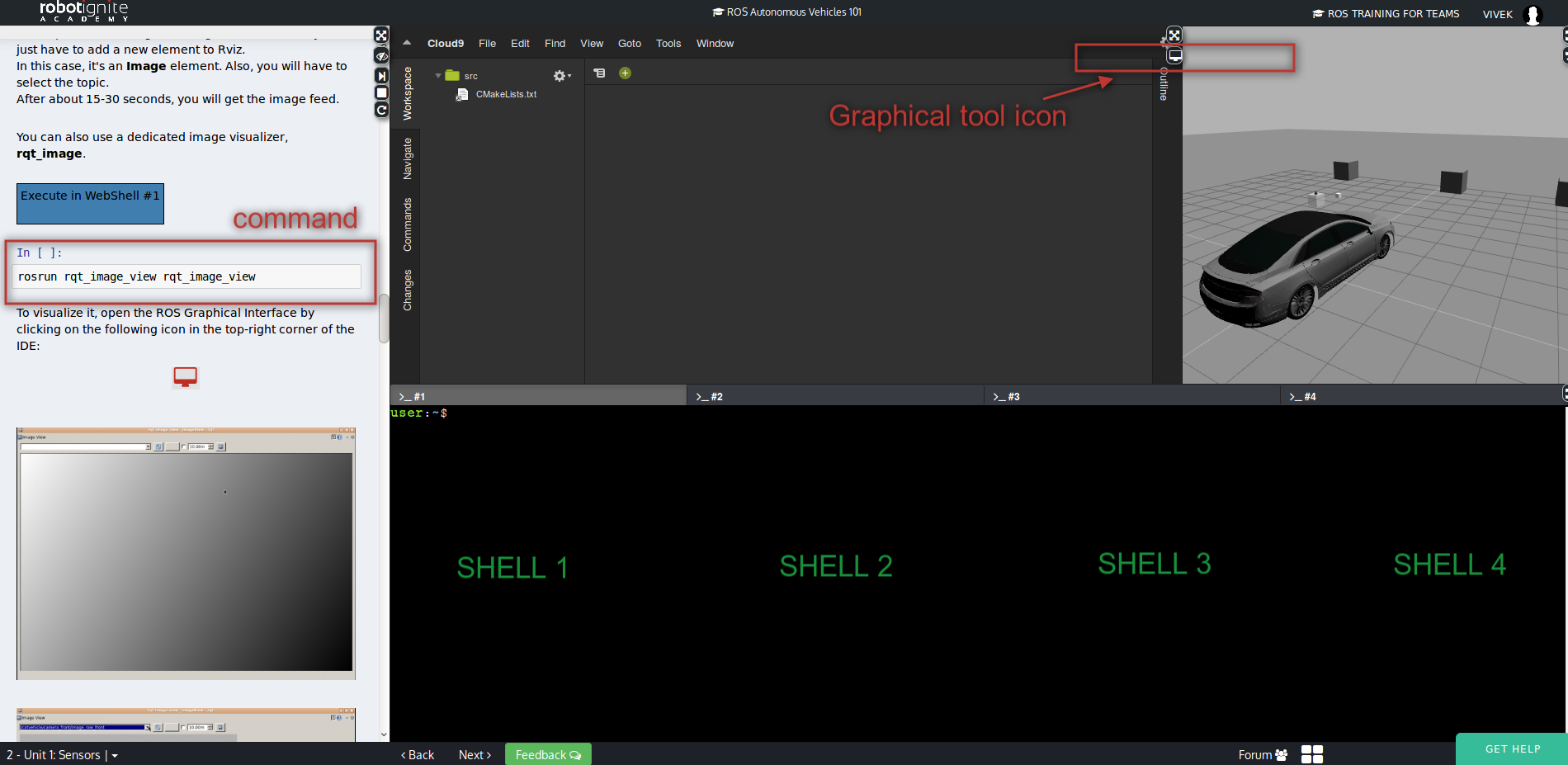

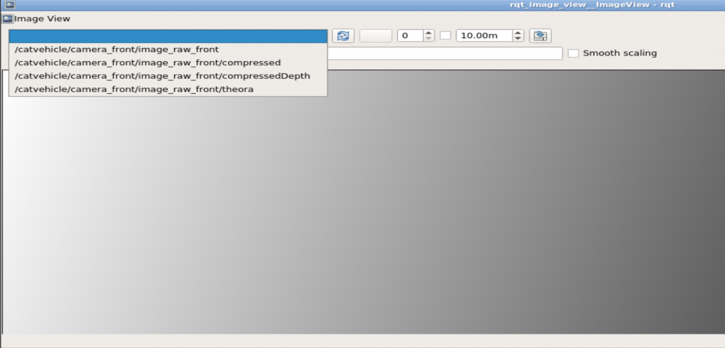

Now we will use the rosrun command to start a rqt_image_view node. Enter the following command in one of the SHELLS
rosrun rqt_image_view rqt_image_view
  • In order to see the visualisation we need to open the Graphical View by clicking on the graphical tool icon shown in the previous image. The graphical view opens in a new tab like follows
Since the model we are using (autonomous car) has many camera topics, we will need to choose one from the drop-down in the graphical view (shown in image).

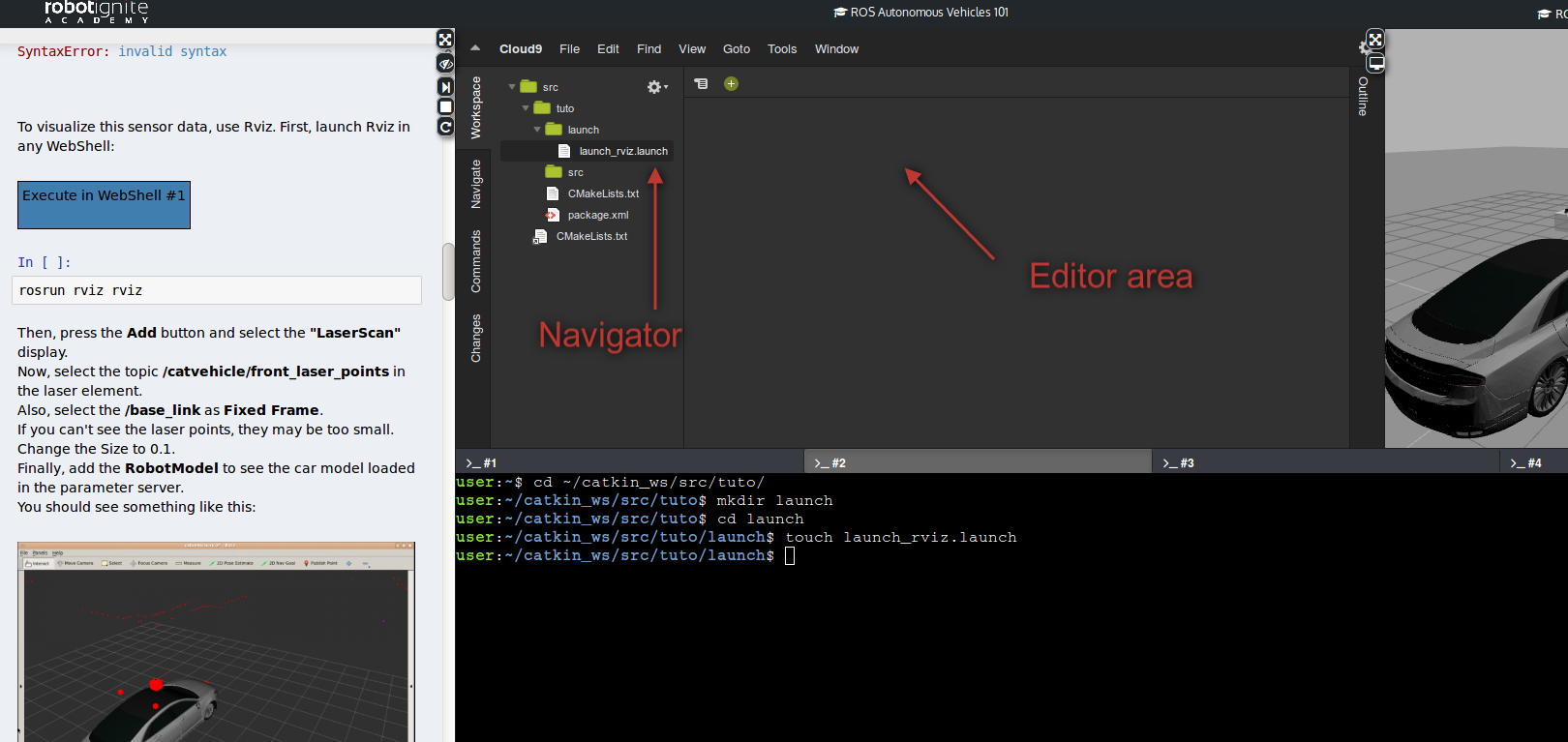

  • rosrun essentially lets us start a single node. However, in many cases one needs to start multiple nodes at a time. To do this (launching multiple nodes simultaneously) we have launch file and the roslaunch command. Lets create such a launch file to launch xyz. Navigate to ~/catkin_ws/tuto/src/ and create a launch directory and create a file inside this directory launch_rviz.launch. Use the following command to achieve this
    $ cd ~/catkin_ws/src/tuto/ $ mkdir launch
    $ cd launch
    $ touch launch_rviz.launch
Next, we will add the following content to this file using the cloud9 editor. Use the editor to browse to the file and then double click on the file name to open it (as shown in image)
The code for the launch file as follows

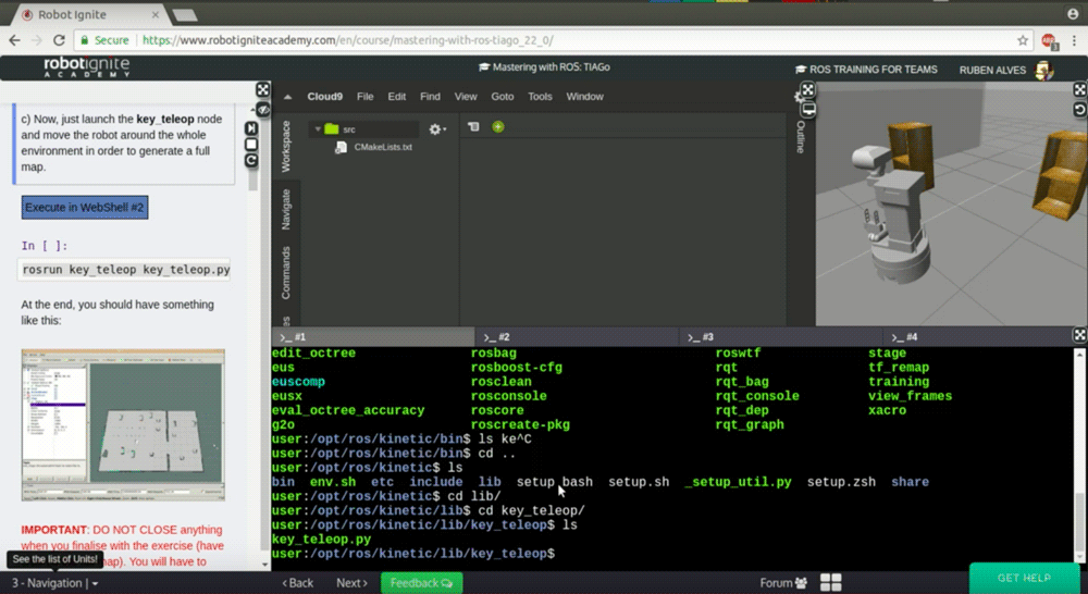

Step2. What is rosrun and how it works?
At first, let’s try the command directly! Please type rosrun key_teleop key_teleop.py in the shell. You can move the robot with the arrow key now. If you type rosrun -h , you’ll see how you can use this command. The command will try to find the executable in the given package and execute it. If you go to the package directly, you can of course execute the executable with ./ command. The rosrun , however, offers you a much faster way to find your executable located in different packages.
