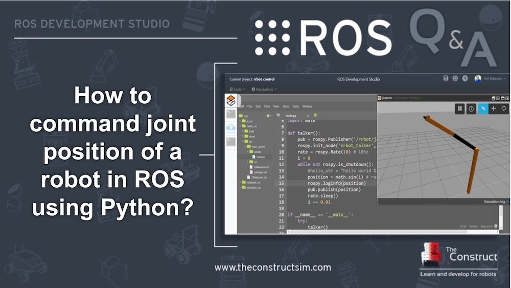

This video extends the excellent tutorial on Gazebo-ROS control by demonstrating a Python script that will send the command to move a robot. The robot is used as an example, and a simple Python code sends joint position command to it through the appropriate topic.

Then we create a script called main.py under the scripts folder with the following content.
#!/usr/bin/env python
# license removed for brevity
import rospy
from std_msgs.msg import Float64
import math
def talker():
    pub = rospy.Publisher('/rrbot/joint1_position_controller/command', Float64, queue_size=10)
    rospy.init_node('talker', anonymous=True)
    rate = rospy.Rate(10) # 10hz
    while not rospy.is_shutdown():
        hello_str = "hello world %s" % rospy.get_time()
        position = math.pi/2
        rospy.loginfo(position)
        pub.publish(position)
        rate.sleep()
if __name__ == '__main__':
    try:
        talker()
    except rospy.ROSInterruptException:
        pass
We can use rosrun rrbot_control main.pyto tun our script(remember to give it permission). You should see the robot move to the desired position. You can also try the code with different position function like sin, cos or even publish to more joints if you want.
