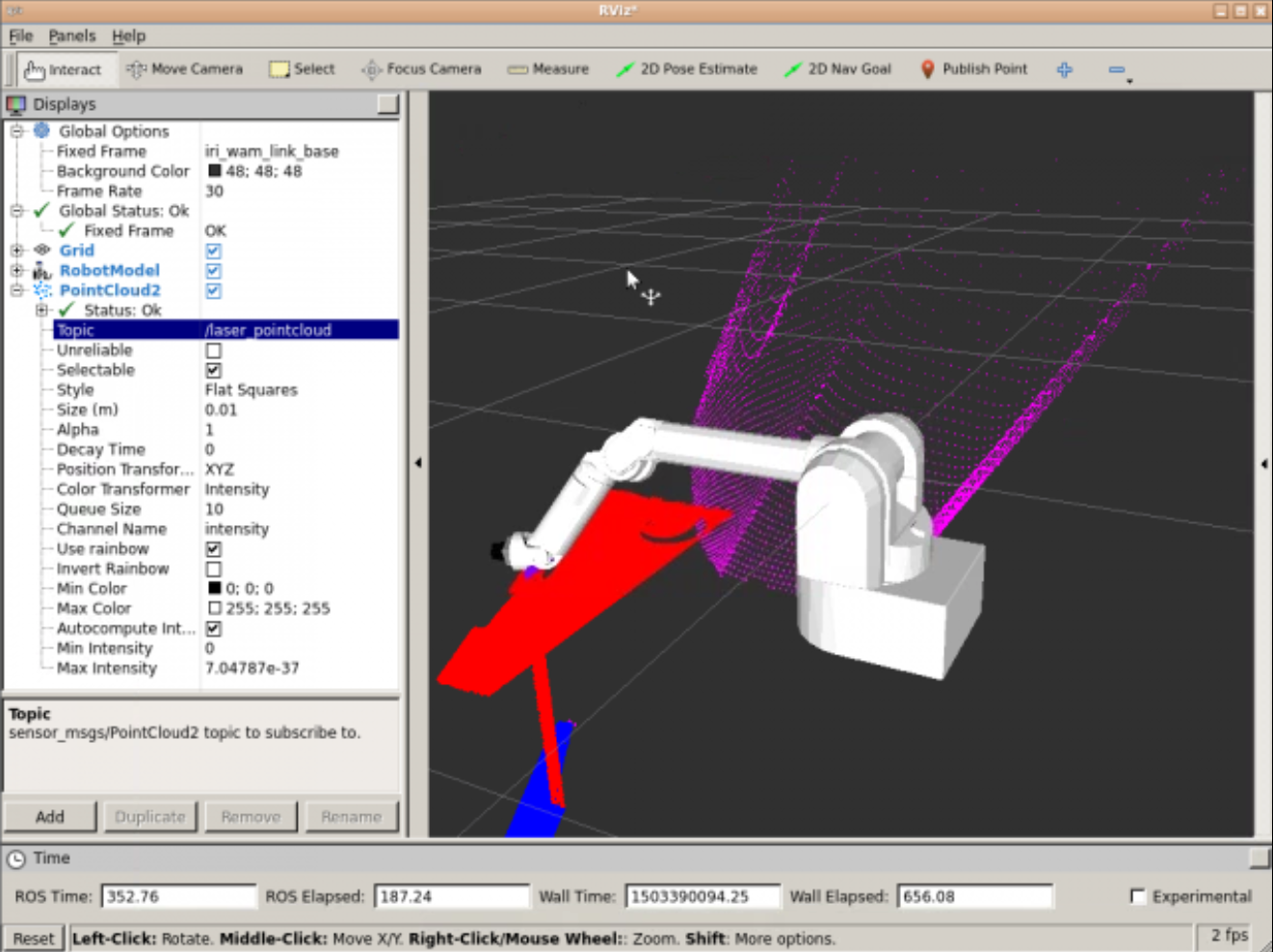

I have been playing around with the laser_assembler ROS package and managed to make it work for assembling several laser scans into a single point cloud, and publish that point cloud on a topic.
What I have done is the following:
1- I created a package that will handle all the logic
2- On the launch file of that package, I launch the laser_assembler properly configured and my own node
3- My node subscribes to the service of the laser_assembler that provides point clouds
4- Then it calls the service, gets the response, and then publishes on a topic as a single PointCloud2 message
Using Python to do the conversion simplifies a lot. Let’s see how to do that using the laser_geometry package.
First, you need to launch the laser_geometry package from a launch file, properly configured. Here a suggested launch file:
<launch>
<node type="laser_scan_assembler" pkg="laser_assembler"
    name="my_assembler">
<remap from="scan" to="laser_scan"/>
<param name="max_scans" type="int" value="400" />
<param name="fixed_frame" type="string" value="my_robot_link_base" />
 </node>
  <node type ="laser2pc.py" pkg="laser_to_pcl" name="laser2pc"/>
</launch>
That file launches the laser_geometry package indicating that the frame from which the transform will be done is the my_robot_link_base (that is whatever tf link of your robot you want the point cloud to be refered from). Another parameter is the max_scans which indicates the max number of last scans that will be take into account for the computation of the point cloud ( this is useful in case your laser is rotating, so you can generate a full 3D cloud).

The code shows how to subscribe to the assemble_scans2 service. That is the one that will provide the point cloud on its answer. The code also shows that the point cloud will be published on a topic of type PoinCloud2. basically, the while loop what it does is, first, call to the service, then publish the answer of the service into a topic.
