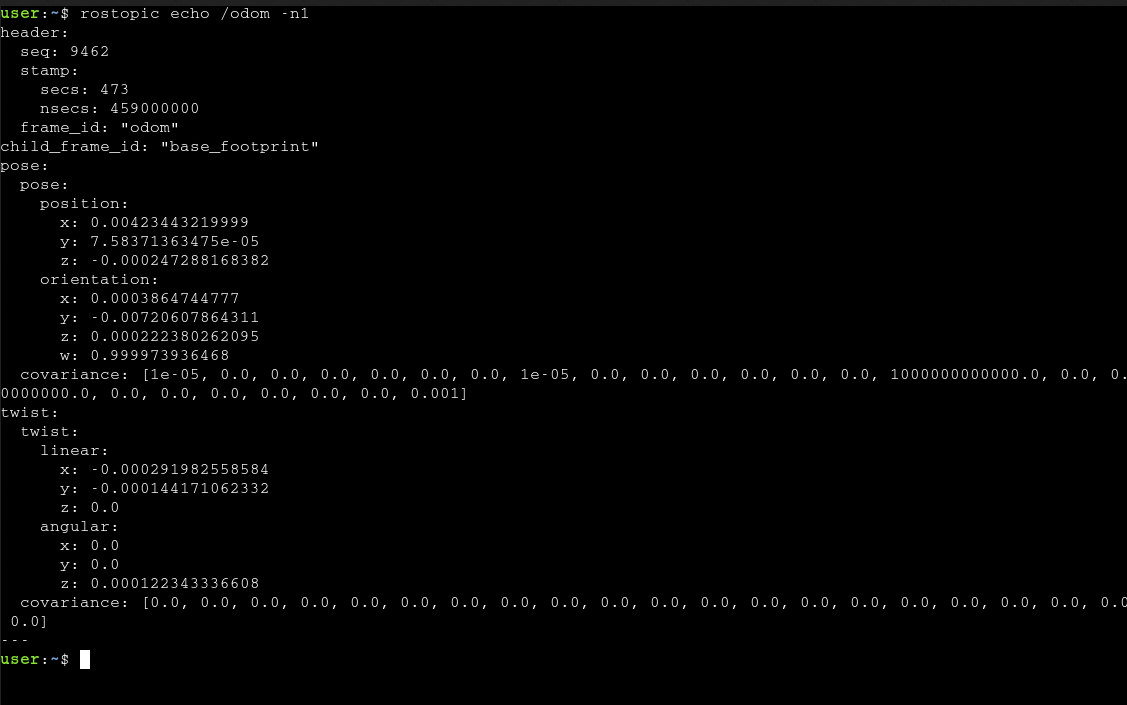

Check for /odom topic in the output of the command. We can now check the information being published on this topic using the following command
$ rostopic echo /odom -n1
The output of the above command should be as shown in the image below (x≈0x≈0, y≈0y≈0)

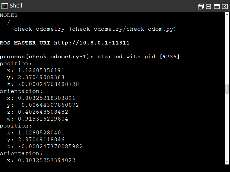

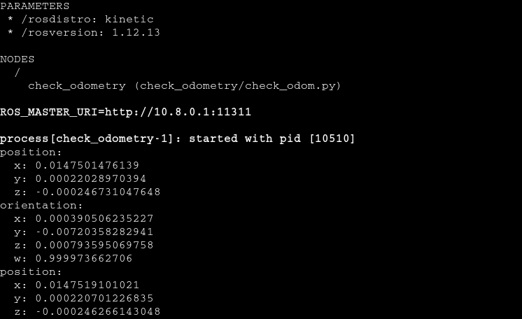

  • Lets launch this launch file with the following command in SHELL
$ roslaunch check_odometry check_odom.launch
The above command should start publishing a stream of Odometry messages (the pose part) as shown in this image

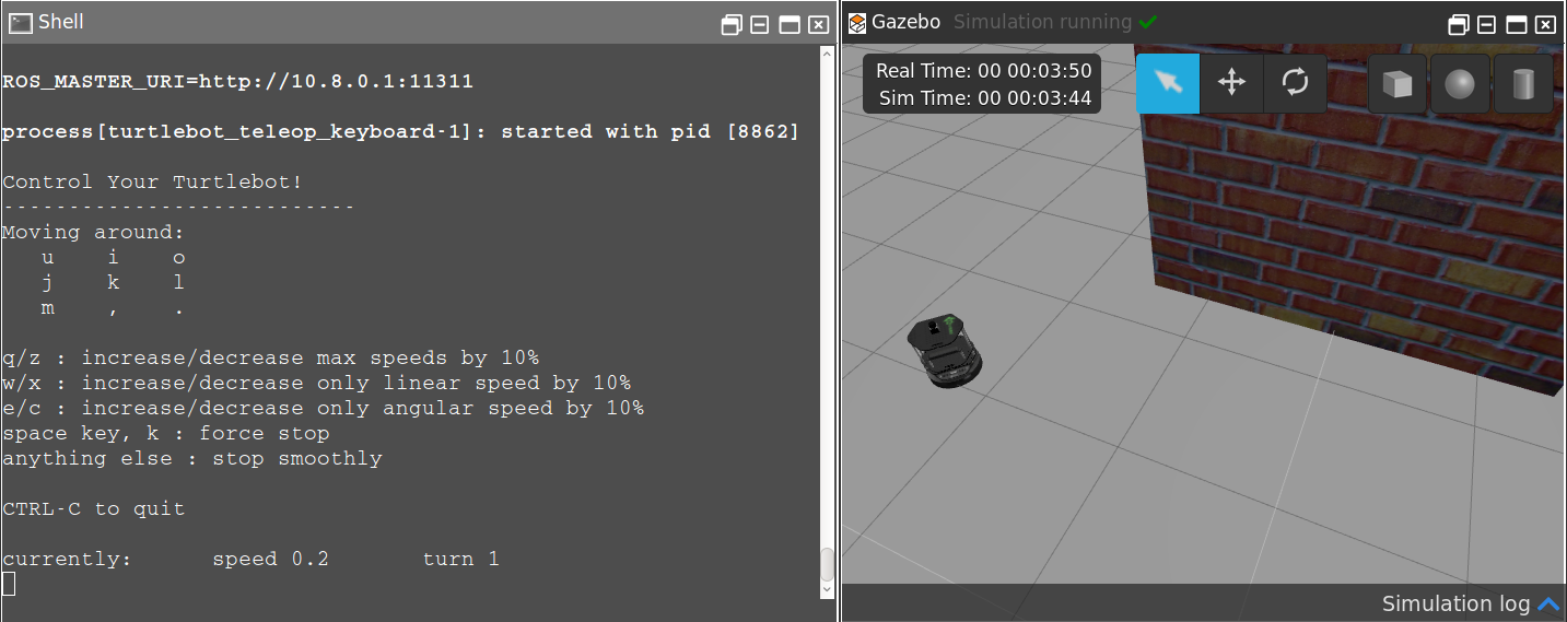

  • Now let us move the robot slightly using the keyboard_teleop and observe the /odom message
$ roslaunch turtlebot_teleop keyboard_teleop.launch
  • Now we can start the launch file again see the change in the location of the robot
