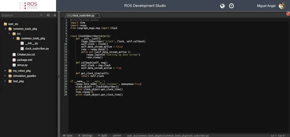

Then you create the module you want under the src folder(e.g. the ClockSubscriber module in the coomon_tools_pkg). You’ll also need a setup.py file with the following content under the package to help the ROS system find this package.

Then you can import the module into other scripts. For example,
from common_tools_pkg.clock_subscriber impot ClockSubscriber
That’s it. You can use modules from other packages now.
