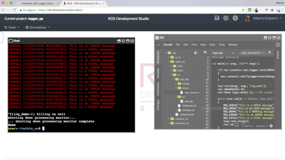

Then we can run the following command in shell to launch the node.
roslaunch logs_test logs_test.launch
Since we set the lowest level logger in our code(DEBUG) we’ll see all 5 levels logs are printing. If you change it(e.g. to ERROR) and compile again, you should only see the ERROR and FATAL message.
