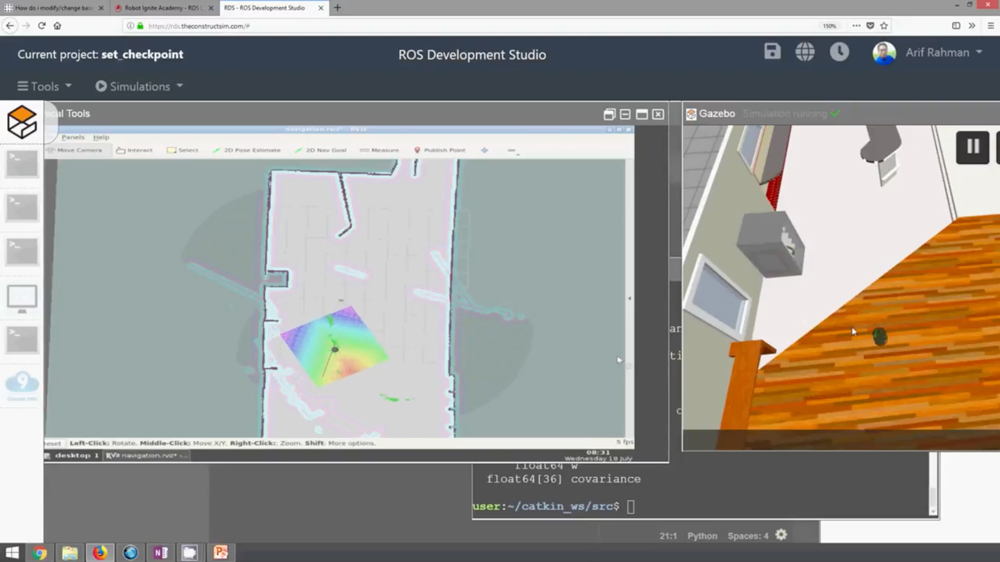

In this video we are going to see how to programmatically modify a robot’s coordinates when it arrives at a known checkpoint. We will use the same technique as clicking on the 2D Pose Estimate in RViz, but with a Python script. This is useful for the robot to know its exact location whenever it arrives at a checkpoint.

In rviz, you can click 2D post Estimate button to estimate the current location of the robot. Our idea is whenever the robot detects a RFID, it will update it’s current location. When you click the button, it publishes a message for you to the topic /initialpose. To check the type of the message, type rostopic info /initialpost , you’ll see that the message type is geometry_msgs/PoseWithCovarianceStamped. If we want to update the pose, we have to be able to send this message.
Let’s create a package to do this task.

In this script, we set the initial point to x,y,z all equal to zero. If you run the script, you’ll see that the robot model moves to the origin of the map!
