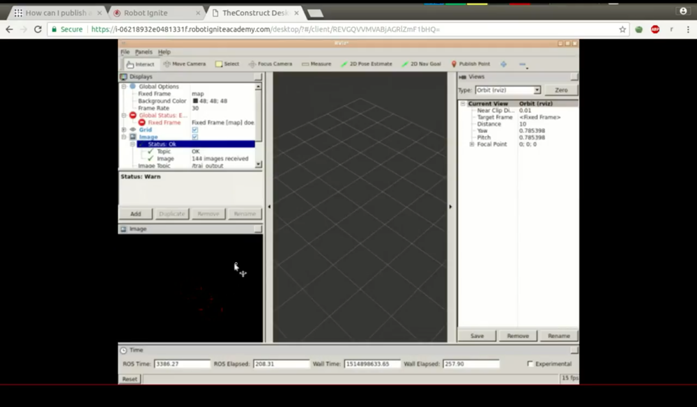

Step3. Visualize image in Rviz
Let’s open rviz with the following command
rosrun rviz rviz
By clicking add->Image and select the topic /traj_output, we still can’t see the image.
It turns out the image only publish once with the original code, to visualize it in rviz we have to keep publishing, so let’s change the code

Then we have to compile and run the node again, you should see the image now.
