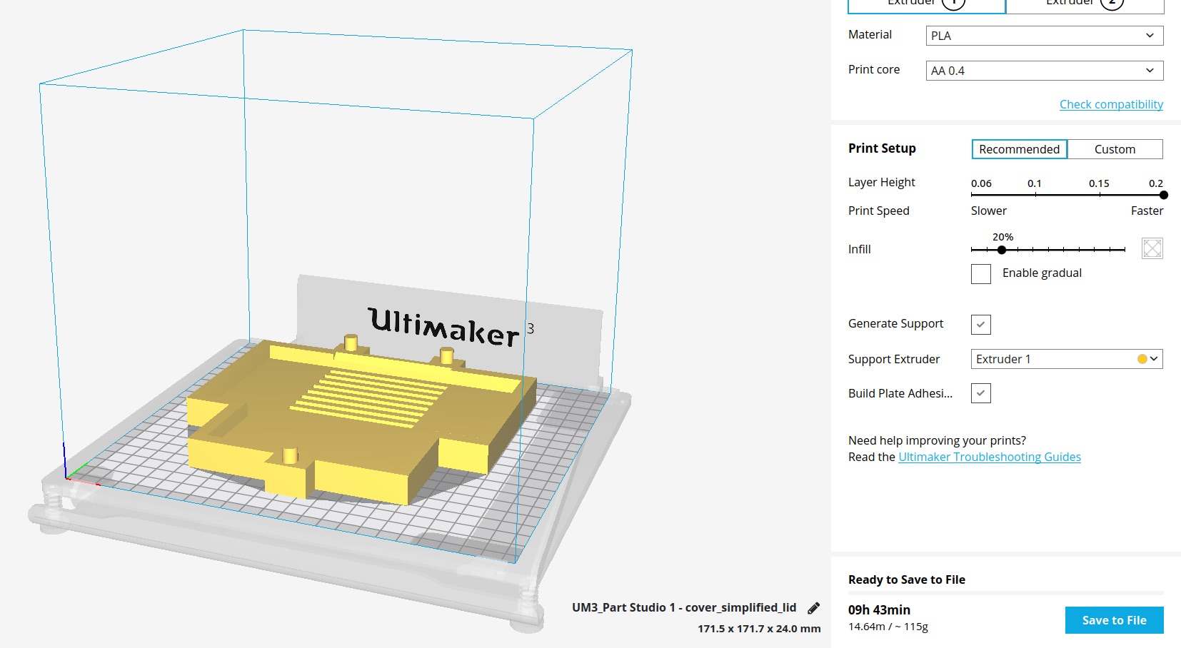

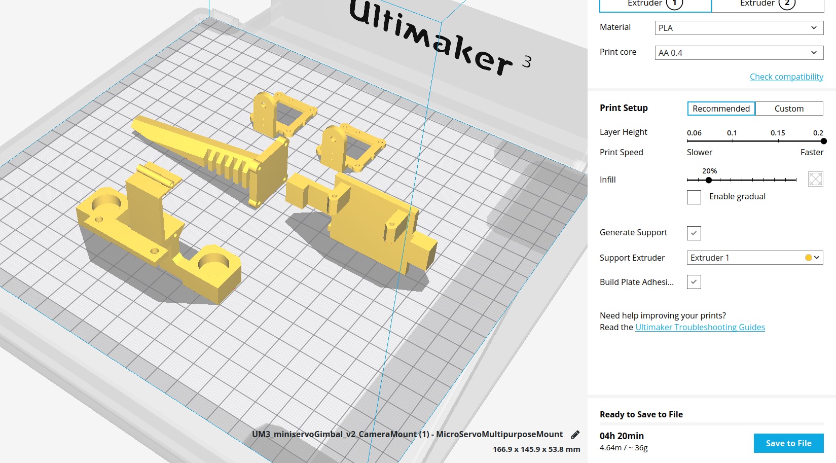

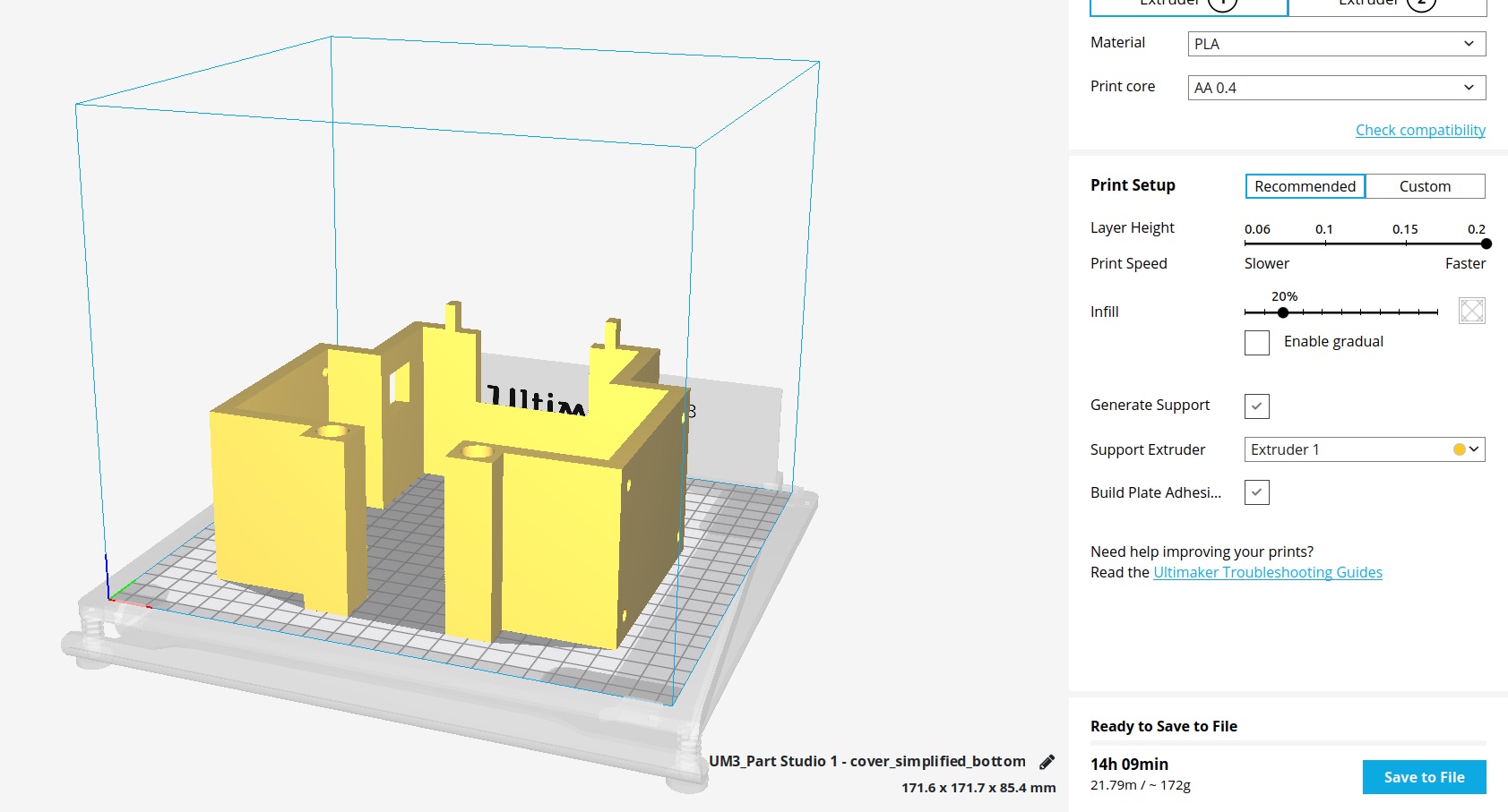

3D print files for IgnisBotLite
The STL parts are in meters as units. If you import them in blender 2.81 using meter units it will be displayed correctly.
Download the latest export here:
