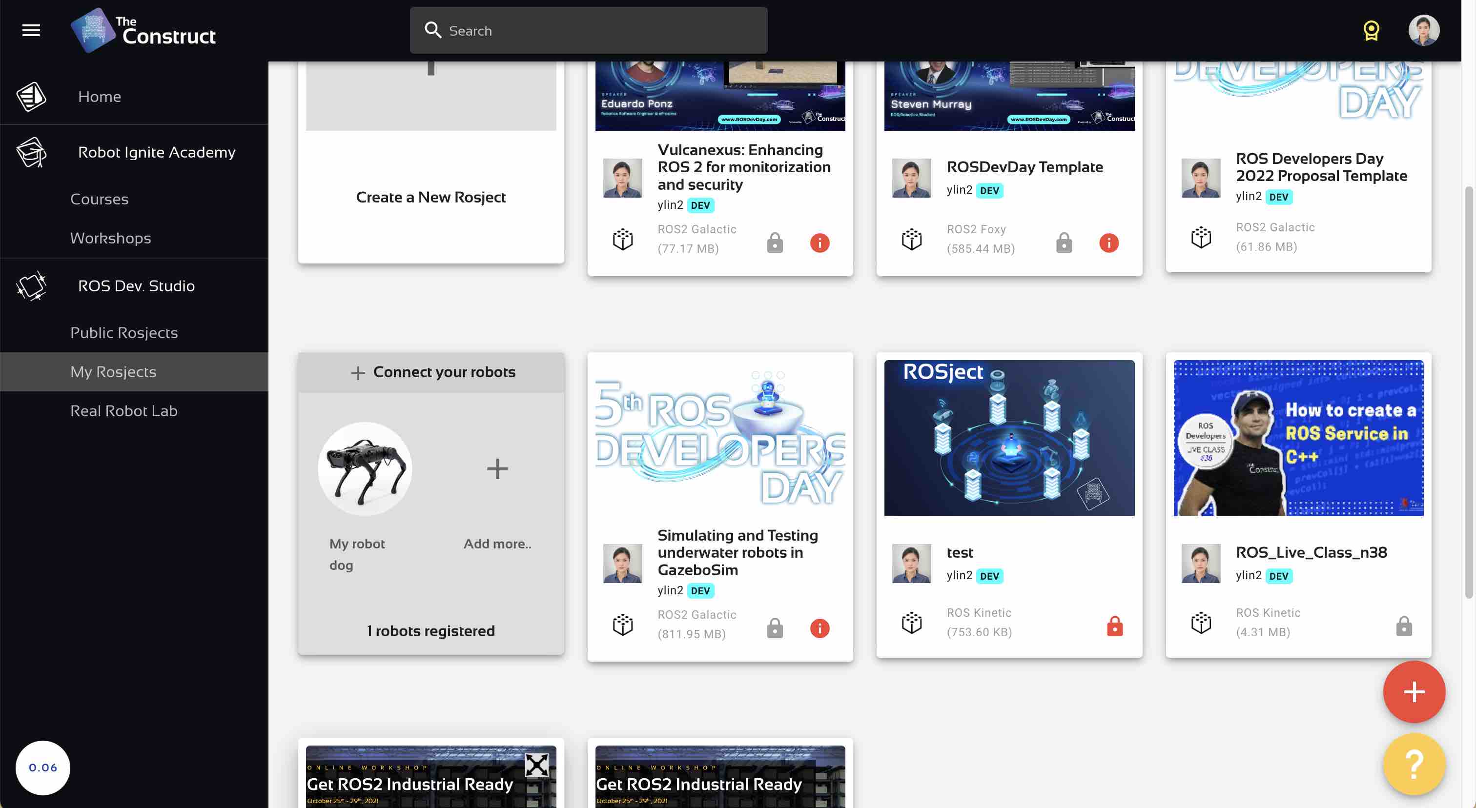

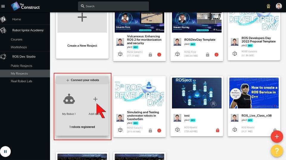

- Click My Rosjects on the left navigation menu
- In the second row of your rosjects, you will see the + Connect your robots session, click on the + plus sign to add your robot

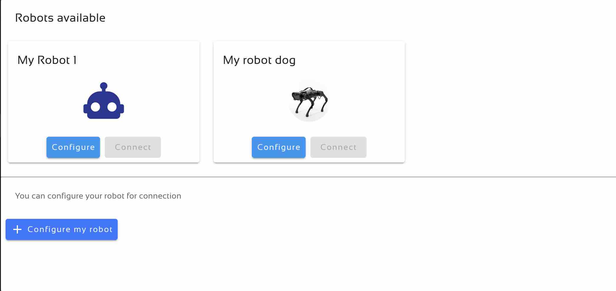

- Click + Configure my robot

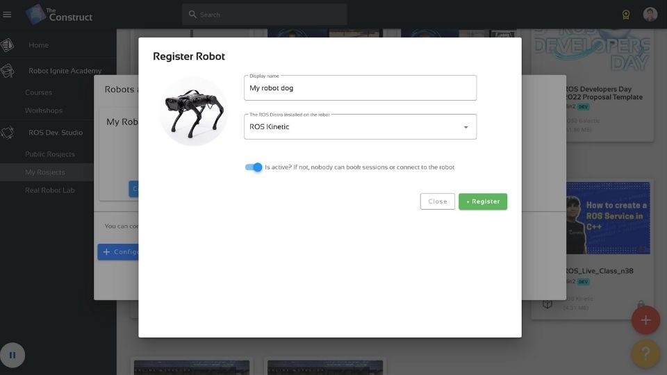

- Click on the camera symbol to upload a picture of your robot, and fill in your robot information (your robot name, robot’s ROS distributions).
- Turn on the ‘Is active’ button (so you can connect it in the rosject afterward).

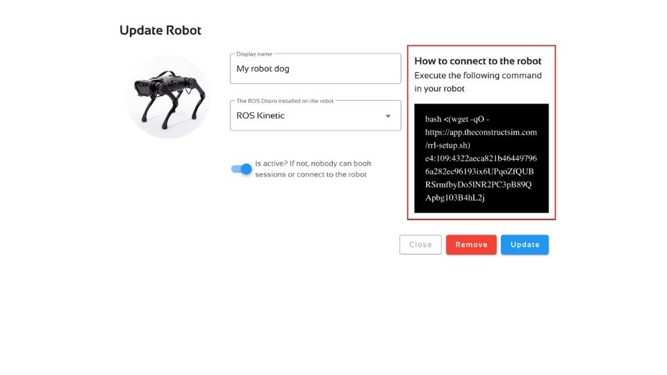

- Click the green button + Register
- Copy the commands in the black box and execute them on your robot.
Congratulations, your robot is now successfully connected to The Construct!

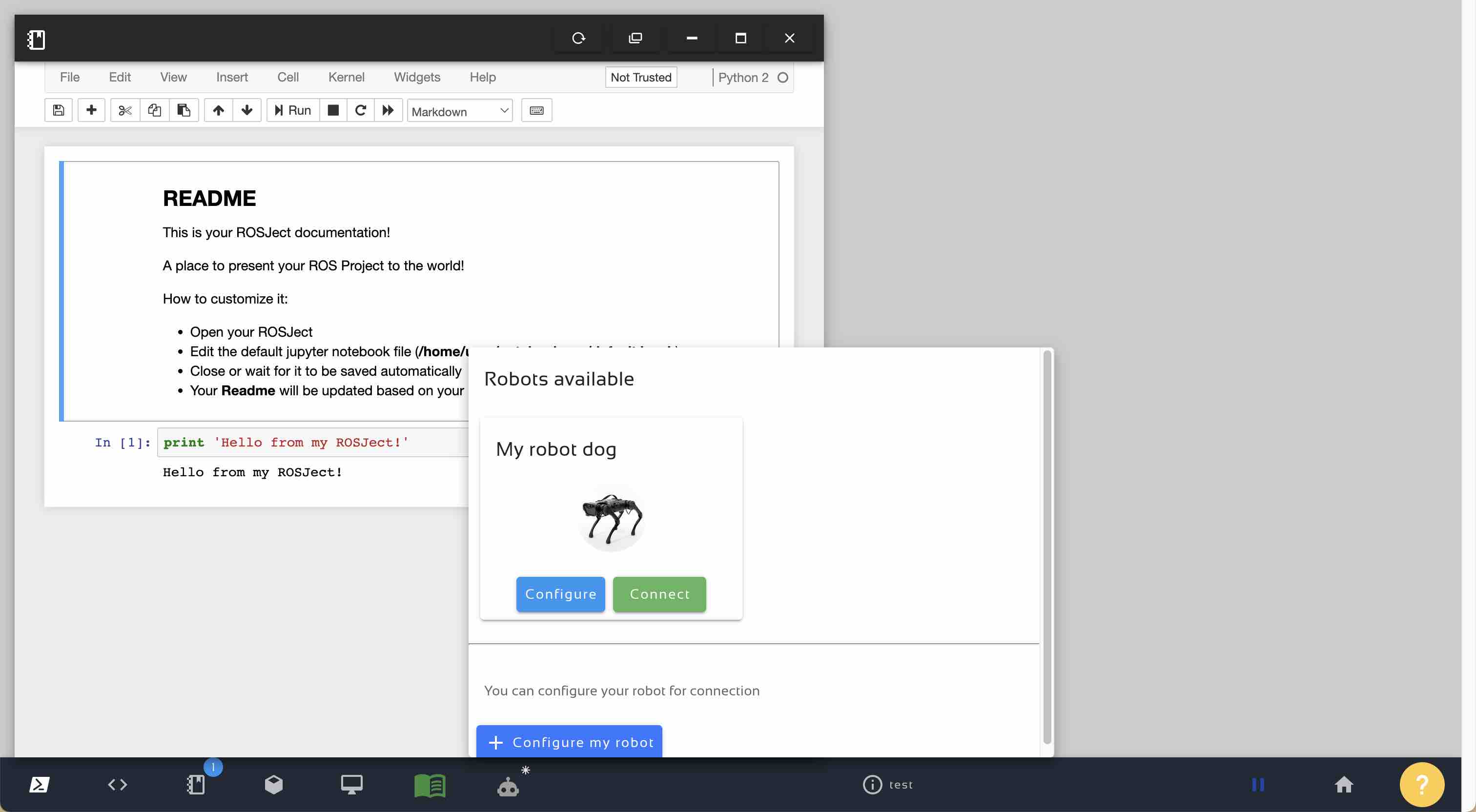

To connect and program this robot in a rosject:
- You just need to open the rosject you want to use
- Click on the Connect to your robots (the robot icon) in the navigation menu at the bottom
- Click the green Connect button on the robot you want to connect to, and that’s it! You can now start using the robot for learning, development, or to share with your students and colleagues!
